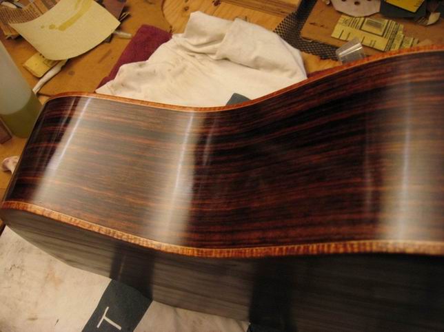

Here are a few progress pics of no. 2. Like Michael Payne said, I too think that EIR takes to French Polishing like crazy.

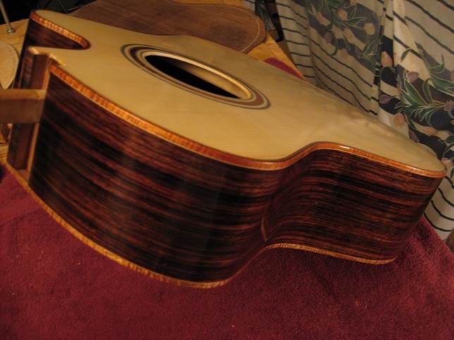

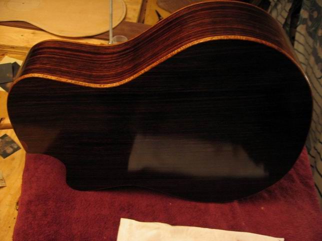

In this first shot I've laid down a wash coat on the back and sanded it back very lightly with 600 grit. The sides have just received their first 'session'.

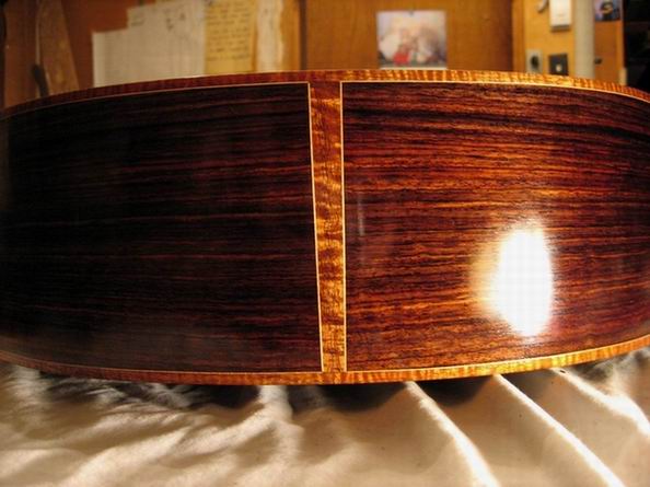

These next shot are after two 'sessions'.
All in all, I am very pleased with the way things are coming along. I think the koa binding really brings out the lighter golden hues in the EIR...

Dave, I filled in the pores with System Three. I just love the stuff. I'm sold on epoxy fillers but I must admit I'm very curious about the egg white thread started by Paul Woolson...
John, don't tease me like that! I'll start to think you're actually serious! I found that FP isn't actually that bad at all, it's the prep work that kills me!
